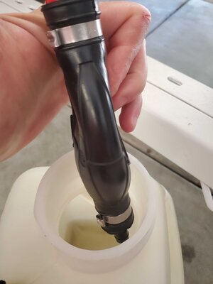

I just tested the fuel system by unhooking the carb's inlet fuel hose and attaching it to a pump siphon. I wanted to see if I was getting any bubbles or any other weird behavior. Sure enough, the bulb of the pump takes forever to re-expand after a squeeze and I cannot initiate a constant siphon, as if there is no airflow into the tank. I believe the pump is creating negative pressure in the tank.
I unscrewed the gas cap, expecting that to fix the siphon issue, which if it did I would have concluded the air inlet check valve up near the fuel selector was bad. But, opening the cap did nothing and it behaved the same. What else could cause this?
