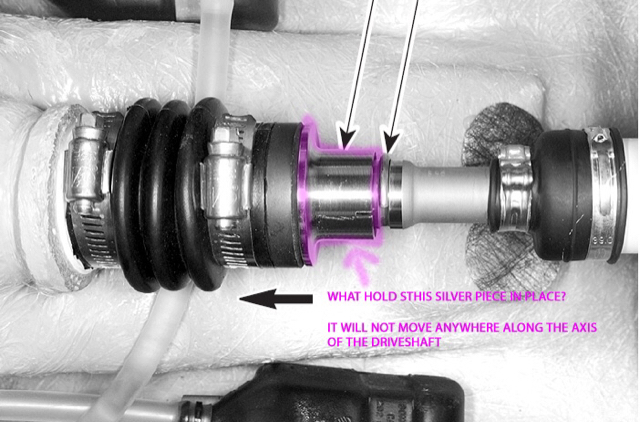

By the way, what is a carbon seal and how would I know if I have one? Is this an aftermarket or stock thing?
This is a CS.
