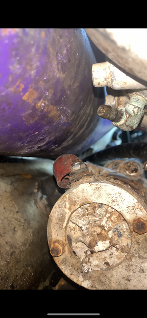

Hello everyone I have a 1995 seadoo xp and the no water is coming out of the pee hole and I tracked it to the 90 on the exaust manifold i I’m not sure hot to take that off any help?
That’s the 90 I need help taking off

Unscrew it, standard threads.
If you are asking how to access it, then you need to split and pull the pipe.
Update had to take the whole manifold off because there was so much calcium built up I couldn’t clean it up underneath but the fitting was good and clean where it screwed in was just FILLED! with calcium
